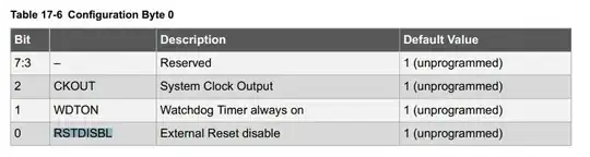

If you really never want the chip to get reset then you can set the RSTDISBL (reset disable) fuse after programming your firmware. Once this fuse is set, the reset pin becomes an IO pin and will not reset the chip even if tied to ground. enter image description here
Note that after disabling the reset pin with RSRDISBL it is harder to reprogram the chip since you might need to use High Voltage Programming (depending on which ATTINY you are using).

  • Where's this picture from? Another answer quotes the manual that says there's no internal pull-up present. Then of course you must have an external pull-up. – Lundin Feb 18 '19 at 08:53
    @Lundin The other answer quotes from the specific datasheet but also from a more generic application note that presumably covers older microcontrollers lacking a pull-up. – pipe Feb 18 '19 at 16:17
  • On what microchips does RSTDISBL make it impossible to reprogram? All of them that I've seen can still be reprogrammed with 12V programming when you do that. – Joseph Sible-Reinstate Monica Feb 19 '19 at 03:13
    @JosephSible I thought you could brick a 2313 by setting the RSTDSBL, but looking at the datasheet, it apparently should respond to high voltage programming. Answer updated accordingly. Thanks! – bigjosh Feb 20 '19 at 01:54
