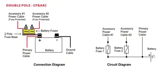

  • @Neil_UK I’m obviously new to these electrical engineering concepts. I have updated my question and added a diagram from the product’s data sheet that may clarify whether the fuses are in series or parallel. – Guru Josh Feb 14 '19 at 09:57

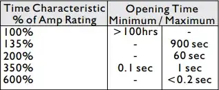

  • @MarkoBuršič I have updated my question and added the fuse specifications. I see that it would take a current with amperage of 200% of the fuse’s amp rating for 60 seconds to blow it. – Guru Josh Feb 14 '19 at 09:59
From your diagram, it looks like the fuses are totally independent and supplying separate circuits, therefore they will both be capable of continuously supplying 100A each.
If one of the circuits draw enough current to blow its fuse, the other fuse would be unaffected.
As @Neil_UK stated in the comments - "They are rated to carry 100A for some 1000s of hours, and will break at some larger current, after some typical time (maybe 200A takes 10s to blow it, depends on the specific fuse, check its specifications)"

  • I have added the fuse specifications to my question. I can see that it would take 60 seconds of current at 200A to blow a 100A fuse. It’s good to understand this concept. I guess my question was more around the concept of whether the amp rating of this terminal with 2 x 100A fuses connected would be the same as for a single fuse holder with 1 x 100A fuse connected or whether it would be doubled. If the 2 fuses are independent then I imagine the rating is effectively doubled. – Guru Josh Feb 14 '19 at 10:37
    You will be able to continuously draw 2 * 100A from the terminal. As it says on the side of the terminal in the photo, it is capable of a total between the two fuses of 300A maximum. – HandyHowie Feb 14 '19 at 11:00
