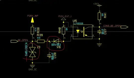

I came across this circuit which I think is to isolate a high voltage signal to a safe level for GPIO of a 3.3V micro controller.
My question is that how on earth this circuit works...There are 2 high voltage levels (28v and 12v) and BE_OPEN is a ~24V/0V signal...which I think comes from a push button.
What V16 does here? doesn't it block any currents that tries to go to pin #3 of the opto-coupler?
What about Z3 (zener diode)...what will happen if we remove it and just short to ground?

  • where did you find this inadequate ESD protector? Not ever web design is optimal. This one is sub-optimal. – Tony Stewart EE75 Feb 12 '19 at 04:02
  • Is this a generic PLC galvanic isolated switch or some application -specific button operated design with extra precautions for long cable length induced ESD voltages. How long is this cable design interface limited to? 5m? 50m? The reason is the ESD charge capacitance at 100pF to 200pF/m for ESD reliability tests. – Tony Stewart EE75 Feb 12 '19 at 06:20
  • @SunnyskyguyEE75 It is about a miniature model of lift so yes there is a rather long cable for connecting the button to the processor – DEKKER Feb 12 '19 at 10:58

But the CA type TVS is a special dual zener back-back diode. enter image description here The TVS acts a brute force 600W absorbing bipolar zener. But this can lead to crosstalk with leakage crosstalk current. A complete analysis is not possible without geometric layout. Basically, a good design but might still cause glitches.
Ref enter image description here Peak pulse power ratings are measured by using laboratory-generated pulses that are designed to simulate pulses on cables caused by nearby lightning strikes. These waveforms are called double exponential waveforms. A standard waveform used in telephone circuits is a 10 x 1000 μs waveform meaning 10 μs rise time and 1000 μs tail decay time to 50% V. AC powered industry uses shorter transients (with lower impedance) which are often tested with 8 x 20 us surge impulses. Often power transformers can pass thru this voltage if the level exceeds the supply protection or is capacitively coupled or the impulse might be induced via the building lightning rod current travelling down (hopefully) not too near the elevator shaft.
A long elevator sensor-cable looks like a great antenna, so low impedance and filters are needed to attenuate RF and surge impulse noise but not too low that it conducts 100A!
The wave is defined by the Vpk, Tr, Td or sometimes Isc. The test requirements are often dictated by Industry safety standards 1st then regional standards, then national std. then international std. Sometimes it is defined by Voc and other times by Isc, short-cct.
Both modes have been supported by TVS's due to very high dynamic range (<<1uA to >10A), fast response time and low resistance. Note that these waveforms are not power waveforms. They are either voltage or current waveforms. To measure peak pulse power, the voltage and the current must both be measured and the peaks multiplied together to get the peak pulse power.
N.B.
In order to attenuate the input applied pulse, the input transient must have an impedance much higher than the TVS. However if this results in a high slew rate current, circuit layout and filters mus prevent crosstalk to nearby high impedance isolated outputs that are unbalanced.
The TVS incremental resistance, Zs at 58V = 1.3 Ω min. ( see graph text added) This TVS is rated for 600W peak pulse power capability at 10/1000μs wave meaning 58V @ 10.4A.
IF a 10A pulse was induced in the TVS, to an optically isolated external DC path, there is still a risk of crosstalk in the supplies, ground planes and proximity to the 10k (R41) pullup , so a shunt capacitance, C127 reduces slew rate to 10nF*10kΩ = 100us is this can result in logic level glitches unless your signal/ground paths are carefully designed to not cause reactive crosstalk with the isolated 3.3V signal ground. This means the 36V and 24V are isolated except for some unknown leakage capacitance and inductance and the crosstalk must be less than exceed Vcc/2R = 3.3/20k = 165uA here or >100 db down from a 10A input pulse !!
This is one attempt to simulate repeated injected impulse voltage dumped from 10nF cap thru a spark gap. The Opto was defined as a Current controlled current source with gain =CTR=0.3 enter image description here
This best attenuation is the 100nF cap which ought to be increased to >=1uF ceramic with a film cap to shunt piezo effects.
HERE is my old explanation of how CMOS ESD protection works. A large cap after the 1st 10K would help in this case doing similar with HV WW resistors and film caps in 2 stages with Sch. diodes so the series R to diode R ratio is about 10k:100R for a chip ESD diode and 10k:5R for a discrete 250mW Schottky diode. This "can" provide robust protection with low current 2 stage clamps, and shnt cap with ferrite beads, if done right.

Z3 is a bidirectional 36 V transient suppressor, like two 35 V zeners in series back-to-back. It is there to limit clip any incoming voltage to no more than 36 V (actually more like 40 V. 36 V is the max voltage it is guaranteed not to clip. (datasheet page 3))
V16 prevents a possible +20 V signal ((36 V - P12V) attenuated by R139 and R140) from appearing across the optocoupler LED and damaging it. Yes it blocks current, but its main job is to prevent reverse voltage.
The 240 Vac signal must be externally current limited or Z3 will fail.

  • Do you understand that TVS diodes have a sharp clamp voltage much like zener diodes? 40 volts forced across a 36 volt TVS diode would burn it up quickly. –  Feb 12 '19 at 03:26
  • The protection must withstand withstand ESD and EFT tests to be IEC compliant on environmental disturbances. Not a good design to have shunt TVS unless it insulated and is shielded or on a ground plane then why bother with TVS – Tony Stewart EE75 Feb 12 '19 at 04:28
  • I understand that the breakdown voltage on the datasheet is between 40.0 V and 44.2 V, with a maximum clamping voltage of 58.1 V (at 10.4 A). https://www.mouser.com/datasheet/2/240/Littelfuse_TVS_Diode_SMBJ_Datasheet.pdf-1108540.pdf – AnalogKid Feb 12 '19 at 04:59
  • Note - the 36 V value is defined on page 3 of the datasheet. – AnalogKid Feb 12 '19 at 05:06
