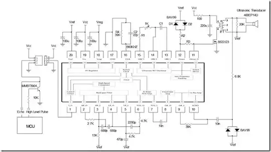

I was thinking of powering the unit through a relay wired direct to the battery and then using the signal from the ignition, in parallel with a timer, to trigger the relay. If I use the loss of power when starting the engine to trigger the timer then the unit has already lost power and it would start loading again, so that would be of no use.
I tried to use the initial connection to power (when the key is first turned to ACC) to trigger the timer. If I am correct then with my circuit the timer is put into an endless 10 sec loop while the key is turned on and when the key is turned off only the timer powers the unit till the end of the time period. If the key is returned to the On or Acc before the end of the time period then the unit will stay on but if the ignition is turned off for longer than the time period then the timer stops and the unit turns off.
(This is also a diesel so needs the ignition to be turned on for a period of time before starting. I'm not sure if 10 secs is enough time but I don't think you can stretch it out further).
Can anybody verify if this circuit will work?
Is there a better way to do this?
If this is the best choice, is there anything wrong and what should I do to fix it?
(I wasn't sure if the 10k and 1k resistors connected to the base of the transistor were needed).

I don't think this is going to work.
When your engine cranks it's typical to see a large drop in voltage supplied by the battery. Even if you keep the radio from turning off deliberately you're still going to see problems with brownouts. Most circuits do better if they're turned fully off than if they're dealing with this sort of brown-out and I think that's what the wiring in your car is trying to protect you from.

  • By the way, you don't need the feedback from the output to the trigger. Or the feedforward from the ACC to output. The discharge pin should be all the feedback you need to create your monostable circuit with the 555. That should simplify your input logic. and let you remove the diodes and most of your combinational logic. – Drew Macrae Feb 10 '19 at 21:55
  • Thanks Andrew, even if this isn't the right solution for my problem due to brownouts I would still like to know if it would work and where my mistakes are. – Berallan Feb 11 '19 at 00:32

Here's a simple relay solution that might be worth investigation.
Figure 1. The two relays hold off radio power until the starter cycle has finished.
How it works:
  • With ignition off both relays are de-energised. Radio is off.
  • When ignition is turned on radio power is still off as RLY1 contact is open.
  • When starter is energised both relays pick up and RLY1 latches. RLY2 is open and radio power is still off.
  • When starter is released RLY1 remains energised over its own contact while D1 prevents back-feed into the starter circuit. Meanwhile RLY2 drops out and power is applied to the radio.
  • Turning off the ignition re-initialises the complete circuit.
Note that this relies on RLY1 picking before the battery voltage drops due to starter solenoid pulling in causing the battery voltage to droop and RLY1 must remain energised at the low voltage. This should be possible so if it doesn't work with one relay then try another of a different type. If you have an adjustable power supply you could measure the pick and release voltage for each relay before testing in the car.

  • Assuming the relays worked as you intended, I can see how this would work but the radio would only work when the engine was running. But I do have an idea on how to solve that, Bridge the contacts on RLY1 with a momentary switch. Would have to remember to turn the key off before starting after using the switch. I wish the power button on the radio actually turned off the unit instead of putting it in standby or just turning off the screen, whichever it does. The momentary switch would also fix the issue if RLY1 did drop out. – Berallan Feb 10 '19 at 10:53

It looks like this circuit would be pulling around 800mA through the coil and BJT which would probably blow both of them. Put a current limiting resistor in there.
