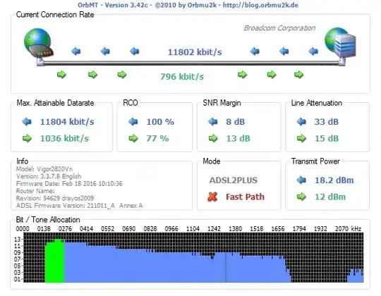

First, here's how the situation looks if I force the modem to sync at ADSL2 speeds only (i.e. use only up to 1.1 Mhz). I do not use this protocol normally, but I included it for completeness.
With ADSL2 only
In this picture, x axis is the frequency and y axis is the number of bits allocated at that carrier frequency. For those with ADSL service and Vigor-brand modems, you can try the same with your service. Connect to your modem's telnet interface and copy/paste the result of "adsl showbins" and "adsl showbins up" commands to https://sdfjkl.org/hack/dmt-visualizer/dmt.html
Second picture shows how it is during normal usage. The unusable frequency band is obvious.
With ADSL2+

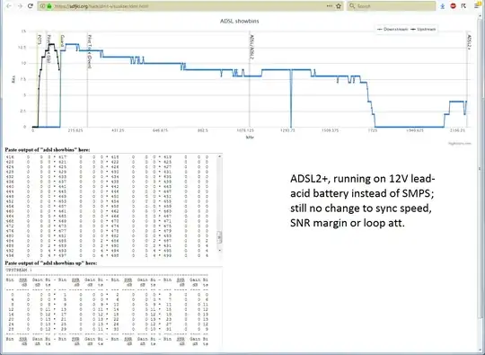

Thinking that it may be noise from the switch-mode power supply, I fed the modem 12V from a lead-acid battery. Third picture shows this case. There's a bit of a general improvement in bit distribution, but those frequencies are still not used.
Running on batteries

My "twist the wires" action seem to have one positive effect: It brought back bin 470 (2026.875 KHz). Yay!!!

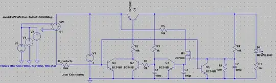

A lot happened since I posted this question. First I purchased the parts for a Schmitt trigger since the cheap signal generator I have did not have the fast enough rise. Then we lost our phone line (I have a separate line for voice calls) for some months. The ADSL line also had its share during this outage: it barely synced at a couple megabits/sec. I could get hold of the ISP field engineer and he told me there's a problem with the "principal wiring" (apparently that's how they call the cabling from the CO to the curbside box) and it's not possible to fix it (he told me it's a bundle of hundreds of small wires so they can't really do point fixes). He said he would try to move our lines to different wires but that did not happen.
Then I got assaulted one night. After spending some time in the hospital and a lot of time in bed, I can now walk though with some limping. Couple months ago, something else happened: The ISP decided to replace the nearly 40-year-old passive curbside box with an active (fiber) box!!! Even though the cabling from that box to our building demarcation box and the cabling from that box to our unit is still the old messy jungle, I can get my assigned speed with no loss. See the latest status:
Finally!!!

So what can be improved?
Cable Impedance is not just wire diameter but the ratio of wire diameter to dielectric thickness or \$\sqrt{L/C}=Zo\$ that controls impedance. This also is affected by number of twists per “ or Cm.
  • Try a large low permeability ferrite magnetic Baluns for entire RF BW to improve CMR (common mode rejection)
  • AC Pi filters? to shunt some CM noise to earth gnd while raising DM impedance and minimizing affects on much lower DM impedance.
  • Better DC ext power “wallwarts” with lower ripple 12V power using lower ESR caps to replace aged ones??
  • Use a Network Analyzer or TDR to test the link?
  • Use the modems internal diagnostics to report link SNR and noise type.?
I would imagine a network of unterminated jacks in the home would cause spectral notches at 1/4 wavelengths around the home unless there is low/high pass LCL filter at the home entrance for splitting of the low frequency audio with the above breakpoint high frequency Phone modem line . I estimate that, this should be done within 10m of the home entrance to prevent the spider or cascaded tapped lines from impedance interference dedicated at the home entrance.
(I don’t know what your phone techs do , but this is what I would recommend.)
16Mbps DS with 100k to 500k US requires a very highly processed SNR in each 4.1x kHz sub-band somewhere in the region of 40~50 dB is my guesstimate to achieve N=15bits/baud. (I suppose some keener may compute this or look it up)
The resulting phase distortion determines the ultimate SNR that makes it possible to modulate 8 or more or less bits per sub-channel explained by Shannon-Hartley theorem for probability of error from inter symbol interference.(ISI)
So check with your ISP provider to determine if they can boost the signal levels for the extreme cable length you have, or get a better line.
Your distance from the CO (central office) is the main issue. The home phone line filter location of the hi/Lo filter installation is one possible cause of degradation if not done at the home entrance from long voice stubs in the home.
Conclusion
The stubs of 15m are 1/10th of 2MHz may be tolerated., but if the signal is already marginal 1/20th of a wavelength may be better and no stubs with the Modem splitter filter is best at the home entrance with a distance perhaps of 1mi or less.
CB and HAM transmitter towers near you cable to the CO have also been known to interfere with ADSL2+ phone Modems.
  • Unfortunately ISP is very uncooperative in that regard. Since they sell the service as "up to 16 Mbps", they say "your cabling is bad" and that's it. It's not possible to get to the technician who would increase the power. Getting a better line is also not an option since they did not convert the curbside boxes to active fiber nodes in this area (i.e. another line would be no better then the one I have, most likely). For your other comments, I made some updates in my original post. – alokoko Feb 08 '19 at 19:18
    Cancel service and get cable data – Tony Stewart EE75 Feb 08 '19 at 21:30
  • I tried that about 5 years ago. It was a painful experience with constant disconnects and all that. The technicians were helpful in that they came and personally inspected the setup and made adjustments to power, but it did not help. One of them finally said the box at the building entrance needed to change since it was from the analog TV era and was not quite suitable for two-way communication. Since they did not do it and did not suggest me a way to have it done, I cancelled the service. The ADSL service is actually rock solid, it just does not perform as good as I would like it to. – alokoko Feb 10 '19 at 11:55
