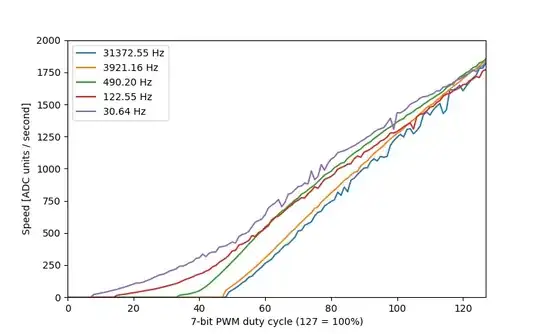

I added 48 to the 7-bit PWM signal, because that's where the motor starts moving at 31 kHz, and then I scale it up to an 8-bit number (because that's what the analogWrite function expects): PWM-speed

  • can you control 31KHz pwm with accurately ? – Hasan alattar Feb 04 '19 at 14:56
  • @Hasanalattar: No, the frequencies I can use are on the second graph (prescaler of 1, 8, 64, 256, 1024). 4 kHz and 500 Hz are audible, so they produce an annoying beeping sound, which I'd like to avoid. That leaves 31 kHz, 120 Hz and 30 Hz. And the latter two are too slow, I think. The PWM resolution is 8 bits, but I'm using less, because my control signal is only 7 bits, and I use only PWM values higher than 96. – tttapa Feb 04 '19 at 15:02

You are correct that the problem is from friction, or possibly a combination of friction and backlash. Your plot of average speed vs. duty cycle for various pulse widths is characteristic of a system with friction. This paper explains what you're seeing, and has a compendium of solutions that have been used since forever to deal with the problems. You will not have seen them in your engineering curriculum because they're hard to analyze; you basically have to fiddle with them on a case-by-case basis to get them to work.
I don't know what commercial controllers do, although I suspect that there are a variety of solutions out there. What I've done in the past with things like this is when the motor drive signal out of my PID controller falls below some threshold (probably 60 to 70 counts in your case) I start pulsing the motor drive at the threshold, with a duty cycle that makes the average drive equal to the PID output. I generally use a sigma-delta-ish modulator for this because it can be implemented in very few lines, but you can go with whatever works for you.
