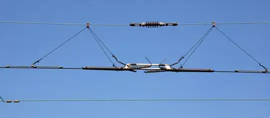

29
For obvious reasons, any railway network is divided into isolated sections and each of those is powered separately from the medium or high voltage grid through its own transformer, circuit breaker and switch.
Two trains within the same section can share power directly. Trains in different sections can only do so through the grid. Since the Oslo Metro uses DC and rectifiers are usually one-way, power sharing through the grid is not available and therefore limited to trains within the same section.
The image below shows a section isolator in an AC overhead line. The sections are powered by different phases of the three-phase high voltage grid for load balancing.
Phasentrenner image source
