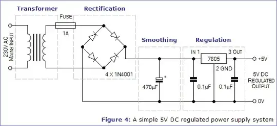

You can always use a transformer (60:1 or so), a bridge rectifier, and a linear regulator, like this: Regulated DC supply schematic
This introduces a bulky, costly transformer into the design, but it's more efficient than the previous design, and your load can vary quite a bit.

    The 7805 in figure 4 immediately reduces efficiency to under 70% due to very high dropout voltage of regulator. A modern LDO will greatly reduce that loss. – Russell McMahon Sep 24 '12 at 01:10
    Russell is right, but an LDO will fix that only partially. You still have to give it some headroom to cover mains voltage variations, the diodes also mean a 30 % efficiency loss. Add transformer losses and even with an LDO you won't get 50 % efficiency. – stevenvh Sep 24 '12 at 06:58

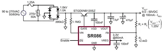

I know it's an old question, but you might want to see the SR086. enter image description here
At Vout you just need to use generic dc reg (e.g. 7805) to get your 5V.
Note: This is not isolated, so it could be dangerous depending on the situation.

  • Interesting IC if there is no isolation required. – Rev Sep 22 '14 at 08:54
  • Cool, that's one of those "why didn't I think of that" ideas... – O'Rooney May 16 '16 at 05:25
    Looks like a standard linear regulator, which will be nowhere near lossless. – user253751 Jul 06 '16 at 03:30

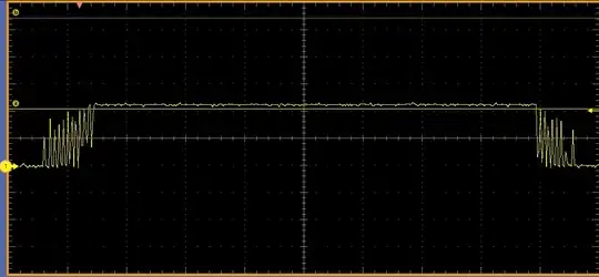

    @immibis It's not a linear regulator. The SR086 makes use of the fact that mains voltage is sinusoidal, by only activating the transistor when the mains voltage is suitably low. This means the transistor should only be operating in saturation or cut-off, implying low losses. The data sheet mentions 55%, which is not lossless, but not bad either for low-power applications. All this, of course, comes at the expense of a horrible power factor. – marcelm Jul 08 '16 at 12:00
  • Price estimation on this circuit? – Zapnologica Jul 20 '16 at 21:21

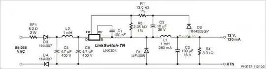

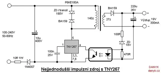

These circuits are so far good enough (taken from the Internet): less components + isolation bonus. enter image description here

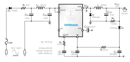

This is second best non-isolated very simple circuit by ST.
In both circuits above the coil or transformer are pretty big and expensive.

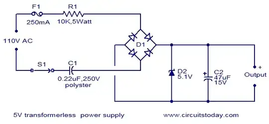

I am mildly surprised that while the Non-Isolating Zener Supply was provided, there is no mention of a non-isolating capacitive reactance circuit voltage divider.
If the device functions within a narrow current requirement, this can be reasonably efficient. The chief issue with the design (well, besides not providing mains isolation) is that you cannot use electrolytic caps (which are polarized), and thus must source uF-range film caps rated at the AC RMS voltage (so a 240V circuit would need caps rated at 350V or higher), which are not especially compact. The capacitance values are also dependent upon AC mains frequency (60Hz in the USA, 50Hz in much of the rest of the world), as well as the actual mains voltage (which will be the case with any non-switching design).
IMO, a MOV (metal-oxide varistor) should be added to all of these designs to protect against line transients. One is present in the SR086 schematic (which curiously doesn't show attribution). That should bridge Line-to-Neutral (for US 120V mains), or Line-to-Line (for 240V mains), and be tapped between the fuse and load (as seen in the SR086 schematic), and ideally before any switches (since a sufficiently high spike can bridge a switch). This will help to protect your circuit - a MOV should handle many small spikes and surges with no problem, and will give its life on the big spike which would otherwise fry everything in your circuit, while the fuse between the MOV and mains will blow if the MOV shorts while doing its job.
I don't have a ready-made schematic of a capacitive reactance voltage divider, but you can find one in the Wikipedia article for Voltage Dividers
Wikipedia article for Capacitive Power Supply. The basic premise is that since you're dealing with AC, the capacitive reactance mimics resistance, but with the benefit of not actually "burning off" the energy - it is stored in the cap and returned to the line on the negative AC cycle.
