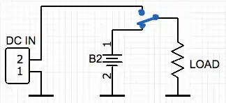

  1. Automatic and fast switching. Actually a 2-position toggle switch can be a good solution here but it will require manually selecting the source:
manual input selection
