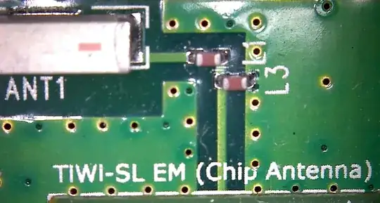

I'm working on a 4-layer PCB that has a wifi module and a chip antenna, the antenna is placed at the corner of the PCB and the copper beneath it is removed, I see that via fences are used on the breakout board of the same module, but the reference design doesn't say much about it, so I was wondering how they work ? how many via do I need ? their placement, sizes and the spaces between them ?
This is the breakout board enter image description here

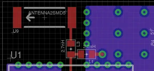

This is my current design enter image description here

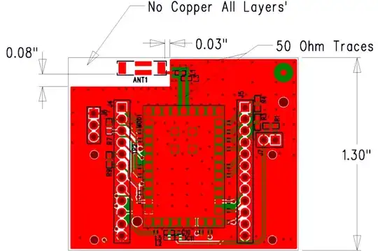

Edit: This is the reference design for the module enter image description here

  • @Jason I followed the reference design as much as I could, it says a lot about the spacing between the antenna and the copper pours, but nothing about the via, would you say that what I have here is good enough ? and can you please send me the link to your question? – mux Sep 24 '12 at 16:04
  • You can avoid the stub in L1 easily . Move up L3 closer to the chip antenna and align L1 to the left with the track. A small detail but it could have a big impact. – Jesus Castane Feb 06 '18 at 11:38

The distance between vias should be 1/4 your resonant wavelength at the most. You only want your antenna to radiate, not the rest of the circuit, i.e., electromagneic radiation. Surrounding the circuitry with vias and planes above and below creates a Faraday cage.
The bigger the via is always electrically better since there is less inductance and less resistance.
The placement is around the perimeter of your aggressive or sensitive signals (keeping radiation in or out).
