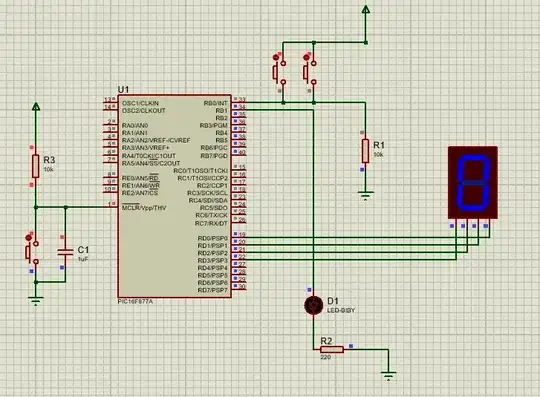

In my code, I have two interruptions, one is coming from the overflow of the TMR0, and the other one is when a button is pressed.
this is the code in MikroC :

what I am trying to achieve with my code is as the following : enter image description here
When I press one of the push buttons, the countdown starts and the LED illuminates until the countdown ends, and if the user pressed the button while the countdown still didn't hit 0, it starts over, until the countdown hits 0 again, then the LED should turn off.
What I'm facing here, is that the interruption from IRB0 works only once, the second time I press the button, nothing happens.
I am not sure if the TMR0F has something to do with that or not, tried many things, but couldn't make it to work.
I Hope that you could see something i didn't notice, and help me.

    @deathismyfriend It is about microcontroller firmware and even has a schematic. It should _not_ be posted on SO where people don't even know the meaning of pull-up, but it should remain here, where it is perfectly on-topic. – Lundin Jan 21 '19 at 12:52
    @Bouzaid There may be a good reason for having several buttons connected to the same input, but be aware that the wire length may have an impact on reliability. See for instance: https://arduino.stackexchange.com/questions/13072/what-maximum-length-of-wire-can-i-use-to-connect-a-push-button-to-an-arduino – mic Jan 22 '19 at 08:10

  • the problem was in the physical aspect, the resistor that lays bellow the bush button has too much resistance (10K), I changed it to 1K and everything worked perfectly. without the use of volatile global variables. – Bouzaid Jan 21 '19 at 13:36

  • I did all that and nothing happened, the problem was in the resistor bellow the push buttons, I changed it from 10K to 1K here the complete new schematics. https://i.imgur.com/P6KQ3to.png for the debounce, in the real project, I'm going to use a flip-flop, just to clarify – Bouzaid Jan 21 '19 at 13:39
    @Bouzaid 10k will work just fine and the value is not critical at all. If changing resistor solved the problem, then the original resistor was badly soldered or something. You still need to do everything mention in this answer, no way around it. – Lundin Jan 21 '19 at 14:08
