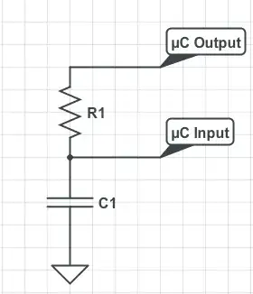

One option that will use only two digital pins is something like this:
Circuit diagram
By changing the R1 and C1 values you can have different charge times for the capacitor that you can measure to determine the hardware version.
