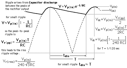

What happens if I omit this part? Actually I don't have 10om resistor and I want to know is there any alternative?
ps: I know what is a zobel network. I want to know what happens if I omit it.

    as stated in the answer (and as you know as you already call it a Zobel network), this is meant to compensate the reactance of the speaker. – Marcus Müller Jan 17 '19 at 14:39
    This network adds a zero in the impedance expression including the loudspeaker and the series capacitor. Getting rid of it can jeopardize the 386 stability in some conditions. – Verbal Kint Jan 17 '19 at 14:39
