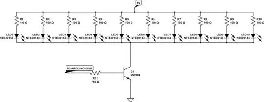

The resistors R1 to R10 are current limiting resistors, for each led from data sheet the forward current is 20mA @ 3.1V forward voltage. from this formula
where Vs is source voltage, Vf is led forward voltage and i is current. we get R nearly equal to 100 (nearest standard value). in parallel led circuit you need to add separate resistor for each led branch, since even though they are with same specifications, but their forward voltages are slight difference and results in some leds lit bright and other dull.. even some times they will burn out. so the best practice is addingindividual resistor in each branch (for individual led)
regarding transistor base calculations
total no of leds: 10 each led consumption : 20mA
so total current is : 20*10 = 200mA is the collector current.
the current gain factor of 2N4401 is 40 @ 500mA (since even though it is 100 @ 150mA, but we crossed the limit consider it as 40)
Ic = hfe * Ib (collector current = gain * base current)
so Ib = 200/40 = 5mA ( this is minimum required base current to get 200mA of collector current).
NOTE: Arduino GPIO can deliver up to 40mA. so you can go for this .If you want to control this even with less base current (based on your question with 4mA, you need an extra transistor in darlington pair configuration
now the base is driven via arduino GPIO (5V) effective voltage across resistor is = 5V - Vbe (base emitter voltage) = 5V - 0.7V = 4.25V
So Ib = V base resistor / resistance => resistance = V base resistor / Ib => 4.25/0.005 => 850ohm so the nearest value with some margin factor will be 750ohm / 820ohm
Electron
  • 2,066
  • 4mA at the base won't reliably drive the transistor into saturation, though -- it'll probably get the collector voltage down to less than 1V, but more than 0.2V. – TimWescott Jan 16 '19 at 23:22
  • @TimWescott So the problem with a "single transistor" approach is that the base pin needs enough amperage relative to the collector's amperage to actually trigger? – Christopher Schultz Jan 17 '19 at 02:37

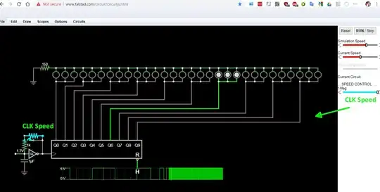

This is the simple Johnson counter method using 10 Cd ~ 20 Cd 5mm 5000k LEDs using only 5mA per LED which is really bright with these ones.
With 30 more resistors you can fade the leading a trailing LED to half intensity
A smoother effect uses resistors and transistors like this. enter image description here
The 50 Ohm resistor controls the brightness and average current and can be paired to 25 Ohms.
Transistor emitter follower approach
Assuming 5V GPIO
If I assumed wrong and it is a 3.3GPIO, then another design is needed. UPDATE aha 3V argh..
So now we need a low voltage inverting open drain HEX switch in DIP chip. http://www.ti.com/lit/ds/symlink/cd74ac05.pdf
With Vcc=3V to 5V the switch resistance < 20 Ohms. which inverts all inputs and the LEDs to common ANODE to 5.0V with no 50 ohm shared resistor now using the open drain resistance.
more calculations needed.
