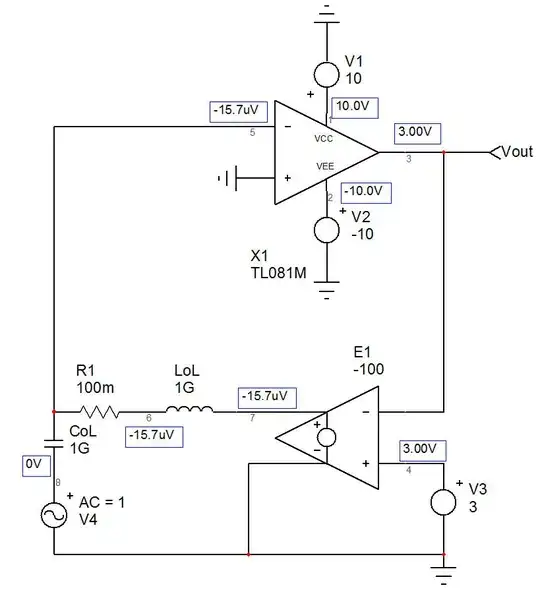

I am trying to do a charging and a discharging Circuit. R8 is the load that Capacitor C1 needs to discharge into when P12V_IN is low.
My question is Why is Vsolenoid low in the interval shown on the waveform when P12V_IN is low? I am expecting that P-FET M2 is OFF during this time so the voltage/charge of C1 should discharge into R8 since NMOS M3 is ON.
I am sure I am screwing up somewhere silly.
