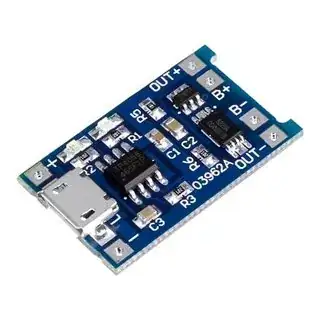

Looking at the schematic of your TP4056 board
you can simply add a pair of diodes of low forward voltage diodes to achieve what you want. SS14 are common and very cheap. Add one diode between the TP4056 IN+ and MT3608 VIN+ and one more between TP4056 OUT+ and MT3608 VIN+.
Your MT3608 will then pull power from USB when there is USB as 5V will always be larger than the 18650 battery voltage.
james
  • 1,662
  • that makes sense to me thanks. I have a stack of A7 diodes with a forward voltage of 1.3V @1A. These should work aswell I assume? – WhiteSpin Jan 10 '19 at 20:37
  • 1.3V is a bit high, at the low end of your battery's range (3.7V) - you'll get 2.4V into the MT3608, and you'll be dumping a significant part of your battery power into heat in the diode. Ideally you'd want a schottky diode (the SS14 has Vf of < 0.5V @ 1A ) – james Jan 10 '19 at 21:26
  • ok then i will get those – WhiteSpin Jan 10 '19 at 23:16
  • If you're wiring up modules you might find a non-smd diode like the 1N5817 (Vf=0.45V @ 1.0A) more convenient as you could heat shrink them into the wiring. – james Jan 10 '19 at 23:47
