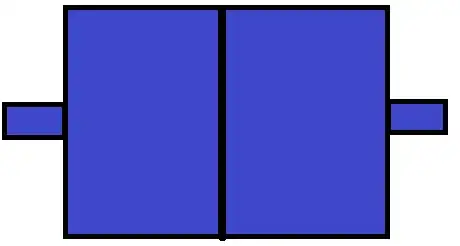

I have a TTL to RS485 driver board and I am try identify one of the manufacturer part number from the board. Can anyone identify the SMD Code and manufacturer part number of the following device?
Code A6530 72130 dimension is 6.6mm x 4mmenter image description here

  • That's weird. The package looks derived from current technology for ICs but the reference designator F1 hints at a fuse or maybe a filter. Also it looks like maybe it was soldered wrong, shifted one pad out of position, though given that the PCB seems to have one larger area rather than match the package pads that may not matter. What is your goal in identifying it? – Chris Stratton Jan 07 '19 at 08:19
  • That's true, it is confusing. I am trying to get schematic out of it. Try to get overall cost of making it. – Lok Jan 08 '19 at 01:30
20
"F1" indicates some kind of fuse, and that "B" is the Bourns logo. Googling "Bourns A6530" leads to the TBU-CA datasheet, which says:
The TBU-CA Series of Bourns® TBU® products are low capacitance single bidirectional high-speed protection components, constructed using MOSFET semiconductor technology, and designed to protect against faults caused by short circuits, AC power cross, induction and lightning surges.
Bourns TBU-CA marking
CL.
  • 18,161
  • 40
  • 67
    Great job! But it would be good to get a brief description into the body of your answer so as not to rely on the link. The fact that it is MOSFET based makes its physical resemblance to an IC package a little less surprising. – Chris Stratton Jan 07 '19 at 08:21
