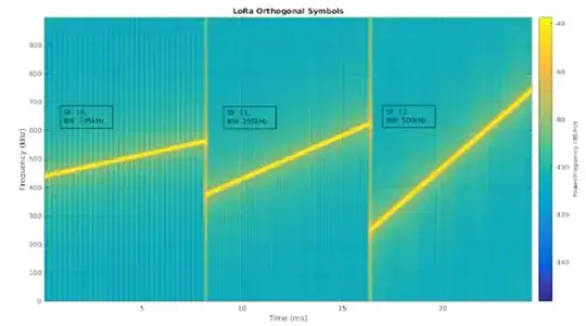

As @Chris Stratton show me in the link http://www.sghoslya.com/p/lora_6.html, I can tell different signal from different SF and BW combination. But I still feel there's a gap that why this suggest orthogonal?
And the frequency-time figure is not the common frequency-amplitude figure that shows signal in frequency domain after Fourier Transformation. How this frequency-time figure used in real signal processing step? enter image description here Also, in https://lab.dsst.io/slides/33c3/7945.html, the author suggested in page 80-83 the demodulation of LoRa. It leaves me the question that why up-chirp multiples the down-chirp result in a constant frequency?
I know from my previous study that the multiplication in time domain equals the convolution in frequency domain. So how does the de-chirp result make sense? enter image description here enter image description here

If you look at LoRa signals in the frequency-time plane on a waterfall spectral display, you will see a series of diagonal slashes which actually encode the data. The transmitter produces this, and the receiver has an algorithm which seeks to recognize something that looks like it, while ignoring anything that does not match the expectation.
LoRa is a propriety modulation scheme, and many of the details are not public, but when bandwidth is fixed, the fact that different spreading factors results in different data rates means it is reasonable to suppose that different spreading factors produces slashes of different slope (different rate of change of frequency vs. time). And diagonals with different slope will have only occasional intersection.
A little web searching turns up a page at http://www.sghoslya.com/p/lora_6.html which seems to endorse this view; however it additionally points out that the bandwidth setting is also a factor determining the slope. And from that makes the argument that there are combinations of spreading factor and bandwidth which would have the same slope as other combinations, and thus not be as fully orthogonal from them.

Different Spreading Factors (SFs) don't just happen to be orthogonal, they are designed to be orthogonal. The fact that they are orthogonal allows them to be easily separated in the receiver, hence the requirement for this feature.
There are many families of encoding that are orthogonal, sinewaves with integer numbers of cycles in a period, and Walsh functions, are just two examples. These both allow information to be spread over frequency and/or time.
