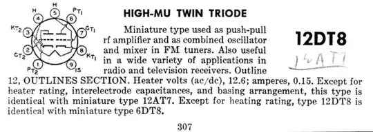

Don't fear the datasheet. Tube datasheets are a fun read. Google for "12DT8" and the datasheet is the first or second link.
Here are the relevant parts for your question:
The heater connections are labeled "H". I believe you will find many tubes have the same pinout. If you look at the radio itself there is usually a label listing the tube complement.

The "12" in the part number indicates that the heater is intended to be powered from 12 V. This one has a separate heater, which usually means it was designed to be run directly from a 12 V tap of the main power transformer. The heater is electrically isolated from the cathode so that the AC doesn't get into the signal (at least mostly not).
Here is the section on this tube from the 1960 RCA Receiving Tube Manual:
This confirms the heater is intended for AC and also tells you the pinout explicitly. Keep in mind that tube pins are numbered clockwise when looking at the tube from the bottom, because that's how you'd be looking at it when soldering wires to the socket. The convention is that there is always one place around the circle that is special, usually a gap in the pins, but it could also be a mark or a nub sticking out or something else. You start with pin 1 going clockwise from that specially marked place. In this tube, the special place is marked by a larger gap between the pins than the other gaps. That is very common.
Just because the heater can be run from AC, doesn't mean it needs to be. You can safely run this heater from a 12 V battery like a car battery or even off of 12 V car power. Car voltage is more like 13.6 when the engine is running, but that's still OK. Don't go higher though.

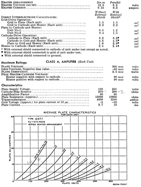

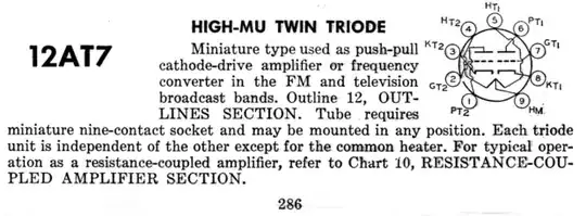

The 12DT8 information refers you to the 12AT7, for which there is considerably more detail:
This extra stuff doesn't matter if you just want to make the tube light up. Just connect 12 V between pins 4 and 5 and it should glow nicely after a few seconds.

  • Load Lines! Good stuff, and a valuable tool that the young ones rarely see. – Scott Seidman Sep 17 '12 at 14:35
    Is µµf an old notation for pF? – starblue Sep 17 '12 at 17:58
  • @star: Yes. At least the double-micro is clear enough even though a bit cluttered. Some old schematics are much worse where they abbreviated "micro" with "m". If it's older than 1990, "mF" probably means micro-Farads, not milli-Farads. Sometimes you will even see "mmF". In that case you know m isn't milli. – Olin Lathrop Sep 17 '12 at 18:13
