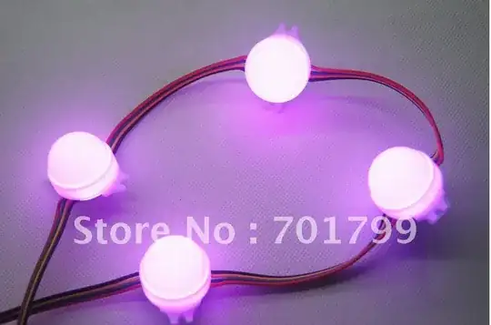

Here's a slightly alternative idea, why not use a ready made solution? You can buy strings of addressable LEDs, and there's Arduino code to control them.
Addressable LED module
There are loads of different types available. Big ones, little ones, strips, RGB, single colours, waterproof or bare PCB. And they're super easy to use. They tend to come in 5m lengths, and you can easily string several together. Or you can buy the individual modules, and wire them up yourself. They're pretty cheap at $1.05 each.
Addressable LED Module PCB
You can get them on eBay, or direct from China from Ray Wu's store at Aliexpress. I have used him before, and been satisfied with the results.
