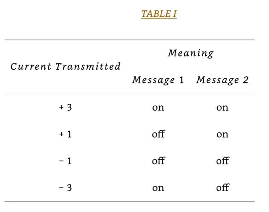

In single-current telegraphy we have two elements out of which to construct our code: current and no current, which we might call 1 and 0. In double-current telegraphy we really have three elements, which we might characterize as forward current, or current into the wire; no current; backward current, or current out of the wire; or as +1, 0, -1. Here the + or — sign indicates the direction of current flow and the number 1 gives the magnitude or strength of the current, which in this case is equal for current flow in either direction.
In 1874, Thomas Edison went further; in his quadruplex telegraph system he used two intensities of current as well as two directions of current. He used changes in intensity, regardless of changes in direction of current flow to send one message, and changes of direction of current flow regardless of changes in intensity, to send another message. If we assume the currents to differ equally one from the next, we might represent the four different conditions of current flow by means of which the two messages are conveyed over the one circuit simultaneously as +3, +1, -1, -3. The interpretation of these at the receiving end is shown in Table I.
Figure II-3 shows how the dots, dashes, and spaces of two simultaneous, independent messages can be represented by a succession of the four different current values.
Clearly, how much information it is possible to send over a circuit depends not only on how fast one can send successive symbols (successive current values) over the circuit but also on how many different symbols (different current values) one has available to choose among. If we have as symbols only the two currents +1 or 0 or, which is just as effective, the two currents +1 and - 1, we can convey to the receiver only one of two possibilities at a time. We have seen above, however, that if we can choose among any one of four current values (any one of four symbols) at a time, such as +3 or + 1 or - 1 or - 3, we can convey by means of these current values (symbols) two independent pieces of information: whether we mean a 0 or 1 in message 1 and whether we mean a 0 or 1 in message 2. Thus, for a given rate of sending successive symbols, the use of four current values allows us to send two independent messages, each as fast as two current values allow us to send one message. We can send twice as many letters per minute by using four current values as we could using two current values.
