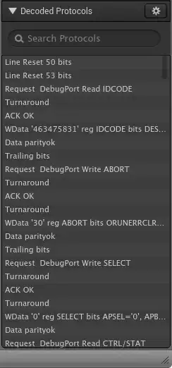

I have tried to compare the output of my GPIO "bitbanging" to the output when using OPENOCD. The first difference is the clock speed, which with OPENOCD and the JTAG-lock-pick-Tiny-v2 is 1MHz, and with bitbanging it is around 22kHz. I have tried with speeds above 125kHz as in "nRF51 Series Reference Manual" on chapter 11.1.2 it says that the minimum clock speed is 125kHz on SWDCLK. No difference. The bit sequence is the same for OPENOCD and my bitbanging, however after the second "line reset" OPENOCD does do the READID as mentioned in the fourth step and some other reads and writes, see image below:
Decoded_protocols_from_openocd
To perform a READID you are supposed to send the pattern 0b10100101, which I added to after my second line reset with no difference. I have used a SALEAE logic analyzer to compare the traffic, see below:
NotWorking Working  OPENOCD
Update/Edit: I edited the config file for OpenOCD to use 22kHz frequency, this also works i.e. no problem using lower frequencies. I downloaded the source code for OpenOCD and edited it to halt after sending the "magic" sequence. It does not work. I then set OpenOCD to halt after reading the IDCODE. Still does not work, so there must be something important in the writes and read.
Update/Edit 2: After digging some more in the source code for OpenOCD, I believe I have found the problem. In the file arm_adi_v5.c, I have added a while(1){} before and after this code:
LOG_DEBUG("DAP: wait CDBGPWRUPACK");
retval = dap_dp_poll_register(dap, DP_CTRL_STAT,
                  CDBGPWRUPACK, CDBGPWRUPACK,
                  DAP_POWER_DOMAIN_TIMEOUT);
if (retval != ERROR_OK)
    return retval;
If the while(1){} is used before it does not work and if we set it after it does work. And extracting the signals from Saleae and diff them in meld I get: meld diff working and not working The different part is:
