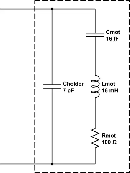

Here's a hopefully close to accurate schematic of a equivalent circuit of a crystal with a series-resonant frequency of 10MHz or so. Someone may object to my numbers, which is fine because I pulled them out of my head, and it's been a while since I've designed an oscillator. I stress the "equivalent circuit" part because all of the components labeled 'mot' are due to the crystal's motion and piezoelectric effect.
Each of those three impedance plots you show are different views of the same thing. The top plot is a logarithmic plot of the absolute value of the impedance over a wide range. The middle plot is of the reactive part of the impedance, while the bottom plot is a "close up" plot right around where the thing will oscillate. They're all different views of the same thing.
When you design an oscillator for a series-resonant crystal, you're trying for an oscillator that may work at more or less the design frequency if you replaced the crystal with a short circuit -- the crystal just makes sure that the "short circuit" in question is exactly at the crystal frequency.
When you design an oscillator for a parallel-resonant crystal, you're using the fact that above the resonant frequency, the crystal looks inductive. In a parallel-resonant circuit, the oscillation frequency is determined both by the crystal and by the total parallel capacitance -- this is why a parallel-resonant crystal is specified for a given frequency and capacitive load.
Dunno if this helps. The discussion is necessarily short -- there's entire books out there written just for crystal oscillators, and all of the oscillator books I've seen have at least one chapter devoted just to crystal oscillators. There's no way to cover all the material just in one Stackexchange post.
