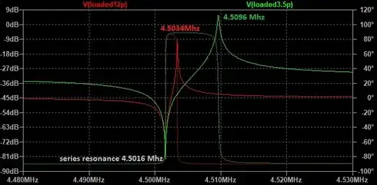

In the picture I provided, there is a curve showing impedance of the crystal with respect to frequency. Why isn't the load capacitance showing in the formulae for the resonant frequencies?

An internal capacitance appears inside the crystal case (Co). It is the capacitance between the crystal surfaces, with quartz as the dielectric. This capacitance is shown in your crystal model circuit as "Cp". This capacitance appears in parallel with the external capacitance (Cp) that your circuit adds. Stray capacitance is included in Cp.
Where you see a crystal specifying a load capacitance, it is generally expected that you would use it in a parallel-resonant circuit, where crystal impedance rises to a maximum, and voltage across its terminals peaks at the desired operating frequency. The operating frequency can be adjusted by varying the external parallel capacitance Cp.
Shown below is the voltage across two identical crystals. For both, the internal parallel capacitance is 3.5 pf between the crystal terminals. The green plot shows parallel resonance at 4.5096 MHz of this bare crystal. It would be difficult to operate this crystal above this frequency.
The red plot shows the same crystal loaded with a parallel 12pf. Its parallel resonance has dropped to 4.5034 MHz.
Note that series resonance for both crystals is 4.5016 MHz. Operating below this frequency would be difficult - some extra inductance would be needed in series. When operated as a parallel-resonator, you can adjust operating frequency in the range of 4.5016 - 4.5096 MHz. by adding an appropriate external Cp. It is a very easy and cheap way of tweaking frequency.
red-a crystal with 12p parallel. Green:same crystal, no external Cp
For an oscillator, a sustaining amplifier is required. It will likely add some extra phase shift that also affects frequency. An adjusted Cp can compensate.
