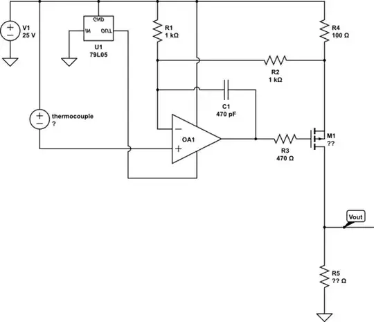

This is a suggestion only. Do a precision voltage-to-current conversion using 25V as your "ground", then do the rest of the work ground referenced. None of the component values I show should be trusted. R1, R2, R4, and R5 set the gain. You need to choose a part for OP1 that works decently with it's common mode voltage at or close to the positive rail -- even with rail-rail amps this is not a hugely common thing.
A bit of theory: M1 doesn't flow current in the gate, so the voltage that you maintain across R4 sets the current. R5 "catches" this current and turns it into a voltage (you want to buffer it immediately with a voltage follower, BTW). R3, C1, and R1 & R2 in parallel compensate the circuit for the FET's gate capacitance (use a wimpy fet with low gate capacitance). The 79L05 provides a regulated rail-5V supply for the high-side circuit.

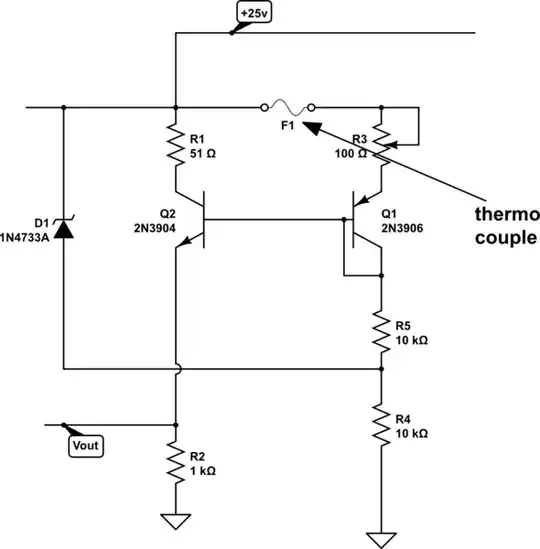

Here is another suggestion:
user2233709
  • 1,705
    That does seem to work pretty well, could you link to somewhere I could learn about how this works? I haven't seen this way of connecting transistors before. Is the model relevant or are ant PNPs OK? – Chumanista Dec 16 '18 at 14:04
  • Also: This leaves quite a bit of DC offset, this could be solved with an op-amp after this, right? – Chumanista Dec 16 '18 at 14:06
  • Put a resistor in the tail of Q2 that matches the resistance of R2, and feed that into a differential amplifier. The *real* shortcoming of this circuit is that the base current of the pair is going to vary a lot over part variations and over temperature, so you can't be sure that your output voltage won't rise above your low-voltage circuit's power rail. The suggestions that use current mirrors won't have that problem. – TimWescott Dec 16 '18 at 16:49
  • @CodeandSolder Sorry, no, I don’t have a good reference to link to explain how this works. And yes, any PNP transistor pair (ideally a matched pair) should work, as long as the \$V_{CEO}\$ is high enough. – user2233709 Dec 16 '18 at 17:01
  • @TimWescott Yes, peufeu’s suggestion may work better than mine. – user2233709 Dec 16 '18 at 17:02
