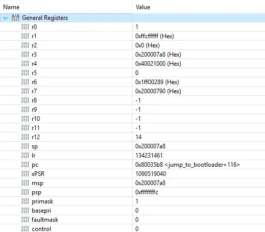

  1. Something could be going wrong with where I'm jumping. As far as I can tell I have the correct address from AN2606. I'm having trouble confirming this when looking at the registers with a debugger. After stepping all the way through jump_to_bootloader(), the code appears to hang, at least according to the debugger... I don't fully understand if I can still trust the debugger after jumping out of my user code. The SP and MSP registers show SRAM adresses (0x20000000 range) and the PC is in flash (0x80000000 start).
Before __set_MSP():
Register values
After stepping to the end of the jump function (debugger step buttons no longer enabled): Register values 2
If I then click suspend execution on the debugger, it brings me back to an Eclipse-generated breakpoint at the start of main(). I don't understand how this could be the case as my application code verifiably no longer functions correctly, both with and without the debugger present.
