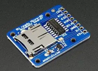

I'm trying to connect the Arduino Lilypad USB to a MicroSD breakout board. I'm unsure which pins to use for the CS, DI, DO and CLK connections on the MicroSD board.

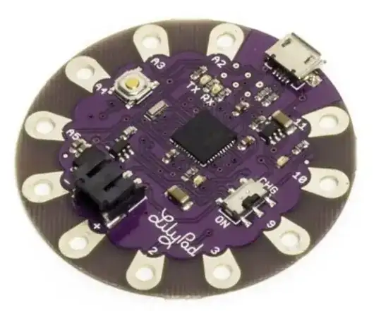

do you see the 2x3 holes? solder a header to it. it is an ICSP header with SPI pins – Juraj Dec 13 '18 at 14:01
Will the normal Arduino Lilypad ATmega 328p not have this issue? – gilianzz Dec 13 '18 at 17:35
what issue? the pins are there. you only need to add the 2x3 header – Juraj Dec 13 '18 at 18:22
It won't be suitable for my project, as I want to use e-sewing. – gilianzz Dec 13 '18 at 18:24
the solder wires into the holes – Juraj Dec 13 '18 at 18:28
normal Lilipad has SPI pins on 'ring' – Juraj Dec 13 '18 at 18:32
