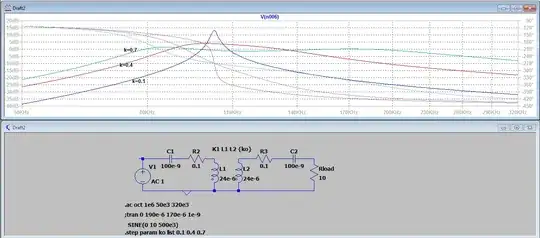

I'm trying to make a inductive wireless power transfer system where the RX coil can move quite conisderably relative to TX coil and still transfer decent amount of power.
The problem I'm encountering is that the most efficient power transfer for a coil happens at a given coupling coefficient, which is usually pretty small ~0.1. But when the coil changes relative postion, the coupling coefficient changes aswell.
Here is a simulation with variating coupling coefficients. enter image description here
What would be the best method to transfer a considerable amount of power while the coil moves aka changes coupling coefficient?

If you are after the maximum power transfer, you need to design your wireless power transfer setup such that the input impedance seen by the source is matched with the source impedance (i.e. zero imaginary part and real part as minimum as possible in this case because your source is an ideal source).
The best parameter that you can control is the operating frequency of your source. When the coupling is strong (\$k>k_{critical}=1/\sqrt{Q_1 Q_2}\$), the maximum power transfer occurs at two different frequencies away from the resonance \$\left(f_{\pm}=f_0/\sqrt{1 \mp k}\right)\$ see the below simulation: if you can tune your source to high or low resonance frequencies (\$f\pm\$), then you can obtain the maximum power from the available setup.
Other options include dynamic tuning of compensation, the use of adaptive impedance matching, active rectifier circuits, and resistance compression networks etc. which are more complex and difficult to implement.

  • When you change the coupling coefficient from 0.2 to 1, we can observe that the transferred power in the top plot decreases. Is there a way to get for example 1 W out(as it is when coupling is 0.2) when the coupling is let's say 0.7 or 0.8? – Raitis Bērziņš Dec 11 '18 at 14:51
  • It will be difficult to get constant power without having a power control from the source. One option could be to operate at off resonance at lower coupling but you have to deliver reactive power fro the source. Also, if you add the source resistance, your power profile will be different- you may not get high power as ideal case at low coupling. – Pojj Dec 14 '18 at 14:22
