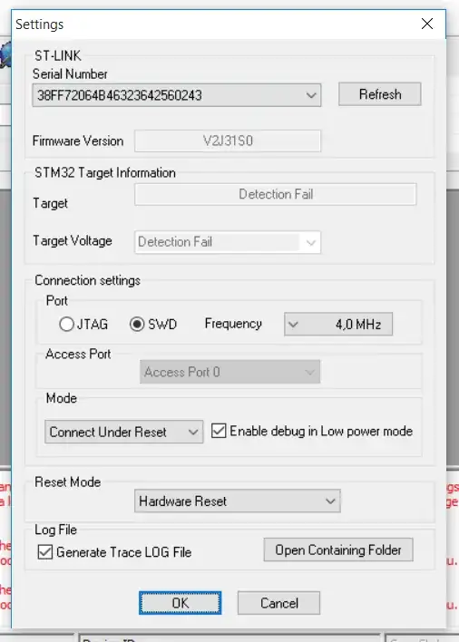

I'm using the Windows ST-Link app to attempt to connect to the board with the following settings: st-link settings

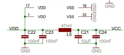

2018-12-03 10:43 edit:
I'm not at liberty to share the entire schematic but here are the SWD connections. Also, power comes over USB through a UART -> I2C bridge and then regulated by a TPS61071DDCR.
SWD connector Vdd -> Vcc

Try changing "Reset Mode" to a setting for software reset. The programmer is perfectly good at sending a software reset command to the chip before uploading code, but it won't try to if you have hardware reset enabled, and since you don't have the NRST pin of the programmer connected to the reset pin on the board, the chip will never get reset.
Billy Kalfus
  • 1,021
  • I've just tried changing the mode to either 'normal' or 'hot plug' and using 'Software System Reset' as the reset mode. In both of these configurations I get a "can not connected to target" error and it suggests I switch mode to 'connect under reset'. When in 'connect under reset' mode the reset mode is forced to 'hardware reset' – Batters Nov 30 '18 at 15:05
