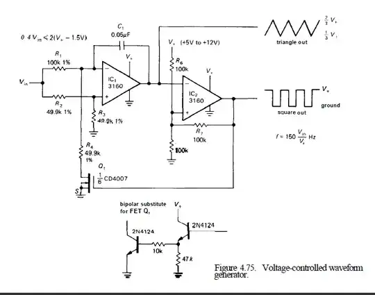

I'm fairly new to LTSpice and I'm having a hard time making this circuit to work. So I'm making an Operational Integrator but my Output signal doesn't seem to match my predictions. enter image description here
If I'm not mistaken Voltage at node Va should be zero since the Operational Amplifier is in a negative feed back configuration. I'm using the Universal Operational Amplifier and I was wondering if maybe the parameters of the Op Amps where the cause of this unusual signal at Va which in turn effects the Vout.

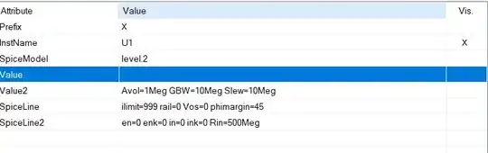

EDIT: Here are some more detailed images relating to my confusion. I understand that the resistors and the capacitors are unusually non ideal for practical use but I just wanted to know why the voltage across the input terminals differ by so much.

  • The saturation is not at all unreasonable, but the positive level is. Assuming the output starts at zero, what will be the slew rate of the output? So how long will it take for the output to saturate? What is your timebase? – WhatRoughBeast Nov 14 '18 at 03:45
  • The slop of the output signal should be -2 volts/sec and I set the initial conditions of Va and Vout to be 0. My Vout signal also hits 2 V instantly which I didn't expect. – Nick Yarn Nov 14 '18 at 03:49
    Even though it's a universal op-amp, it's still going to have somewhat realistic parameters inside. That means that your resistor is insanely small and the cap is insanely big. Try a 10k\$\Omega\$ resistor and a 100\$\mu\$F cap -- see if things get better. – TimWescott Nov 14 '18 at 04:08
  • There's not enough info in your picture. I can't see the .TRAN card, for example. So no clue what you are doing there. But looks like the default case of .TRAN 1. If so, the spice program will go through a process of calculating the steady state and initialize things to those values. That's not usually a good thing for integrators without shorting switches available and periodically active. It doesn't start where you think it starts. So it doesn't yield what you wish it would yield. – jonk Nov 14 '18 at 04:08
  • In addition to Tim's excellent suggestions about the values (an opamp can't drive amps at its output, except in a very few cases), try setting the UIC checkbox on the .TRAN card, as well. Those two things (value changes and the UIC checkbox) should give you something more as you expect to see. – jonk Nov 14 '18 at 04:17
  • Ok, will try. I edited one of the parameters for the Universal Op Amp called iLimit which was set to 25mA so I bumped it up to 999 A. I understand that the current draw is very large but I don't understand the instant increase in the voltage across the output terminal of the Op Amp – Nick Yarn Nov 14 '18 at 04:32
  • Just added more info to the situation – Nick Yarn Nov 14 '18 at 04:41
