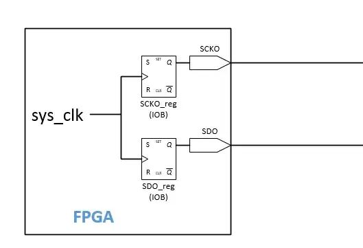

Below is a drawing of the system; SDO and SCKO are outputs of the FPGA:
A drawing of the system: SDO and SCKO are outputs of the FPGA.
