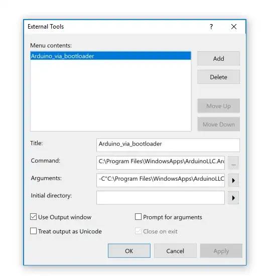

step 2) I navigated to AS7 "Tools" menu, then "External Tools", then created a build tool titled using copied paths from step 1 "Arduino_via_bootloader":
I set the value of Command =
C:\Program Files\WindowsApps\ArduinoLLC.ArduinoIDE_1.8.15.0_x86__mdqgnx93n4wtt\hardware\tools\avr\bin\avrdude.exe
And the value of Arguments =
 -C"C:\Program Files\WindowsApps\ArduinoLLC.ArduinoIDE_1.8.15.0_x86__mdqgnx93n4wtt\hardware\tools\avr\etc\avrdude.conf" -v -patmega328p -carduino -PCOM6 -b115200 -D -Uflash:w:"$(ProjectDir)Debug\$(TargetName).hex":i
Clicked OK & apply.

step 5) Finally, I navigated to the "Tools" menu & selected my custom build "Arduino_via_bootloader". However nothing happens, AS7 Output console is empty to messages, no errors, no feedback? And the board is not blinking. How can fix this build process???

Check the "avrdude.exe" and "avrdude.conf" location installation, which I used the Microsoft Store to install the Arduino IDE. When executing the "avrdude.exe" on the command line, there is an "Access Denied" error, that is the reason why there is no Output on the Atmel Studio.
The solution I did was to copy the "avrdude.exe" and "avrdude.conf" to another folder, say on the "Atmel Studio" installation folder. Change then the Command and Arguments on the "External Tools" to use the copied avr files.
