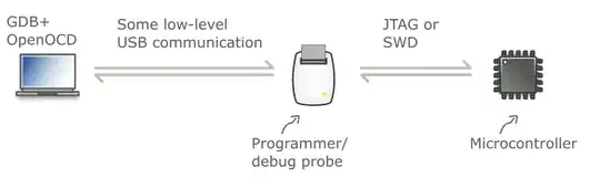

1. Programming a microcontroller
To program and/or debug a microcontroller, the following procedure is common:
There are tons of different probes on the market. The communication between the probe and the microcontroller is standardized in the SWD and JTAG protocols. The communication between the probe and the host computer is unfortunately not standardized. That makes the job of OpenOCD very hard. This software - running on the host computer - attempts to connect to the probe. Just imagine how much work the OpenOCD folks have to support all of them!
ARM makes an effort to standardize this USB-communication between the probe and the host computer.
2. The CMSIS-DAP standard
CMSIS-DAP is the specification (or standard, or protocol, or ...) from ARM, defining how a programmer/debug probe should be built. From my understanding, it specifies some hardware aspects as well as the communication protocol between the host computer and the probe(1).
