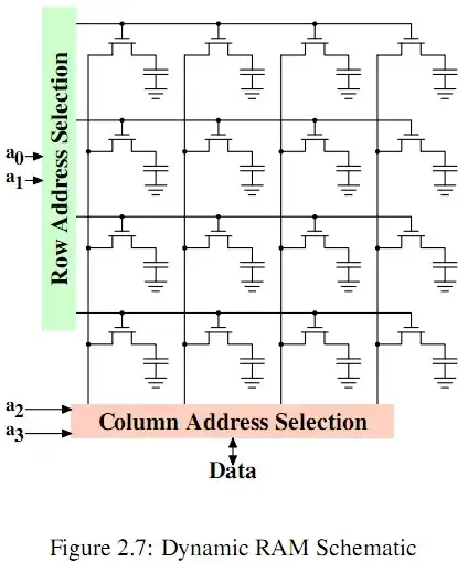

Memory cells are arranged in a matrix
This is a 16-bit memory, 1 bit wide, so it needs 4 address lines to address each individual bit. That's the a3..a0 lines at the left. a0 and a1 enter the green 2-to-4 demultiplexer. An N-input demultiplexer can have 2\$^N\$ output lines, and the binary input indicates which of those will be active. That's the row select.
The column select does something similar, but uses a multiplexer to select 1 of 2\$^N\$ lines as the output signal. So the combination of row select and column select can address an individual memory cell.
This is Random Access Memory because any bit is directly accessible, no matter what the address is. And it goes for DRAM as well as SRAM. SRAM needs more hardware to store a bit (4 or 6 FETs) than the DRAM shown, which needs only 1 FET per bit. The data is stored in the capacitors. Capacitors have leakage, and after some (very short!) time the data will be gone. That's why DRAM needs frequent refreshing: the data is continuously read and rewritten between accesses. This adds some extra hardware to the device, but a DRAM die is still much smaller than an SRAM die with the same capacity.

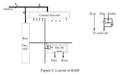

RAMs are organised as square arrays of individual bits. There are two decoders, a row and a column decoder, and each one bit memory cell is only enabled when both its row and the column lines are one. In the case of a 256 bit RAM each decoder transforms a four bit binary number into a sixteen bit unary number. Thus, in the square array of one bit memory cells, there will only ever be one cell for which both the row and the column lines are one. Each cell is connected to the same read/write line and data line. The data line is connected to the outside through a two way tri state buffer, such that unless the chip is enabled no data can pass either in or out.

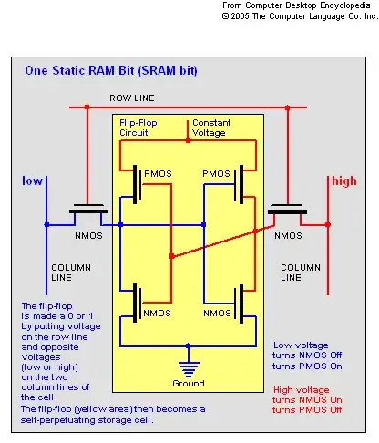

A Static RAM data at its heart has a bistable latching circuitry (usually four or six transistors) to store a single bit while Dynamic RAM uses capacitive method of storage for a single bit(only one transistor and a capacitor).Thus a DRAM is capable of holding memory in more denser way than a SRAM.Since capacitive memory is prone to leaking DRAM requires higher refresh rates to maintain the bit information inside memory cells.
