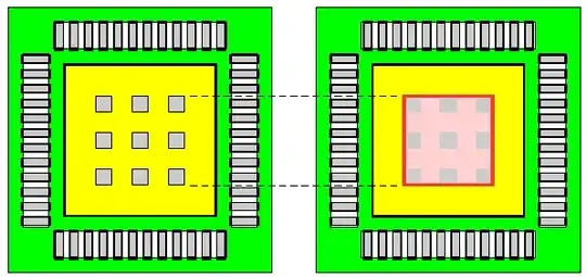

Note that when you use a thermal pad on your PCB that you shouldn't apply solder paste all over it, but use a windowed stencil to avoid the IC being pushed up by the solder paste:
"The solder paste pattern area should cover 35 % of the solder land area. When printing solder paste on the exposed die pad solder land, the solder paste dot area should cover no more than 20 % of this solder land area. Furthermore, the paste should be printed away from the solder land edges. This is illustrated in Figure 9; the solder paste pattern area lies within the boundary indicated by the red line and it is divided by the entire solder land area." (from here)
