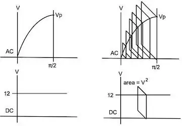

Our analysis need only consider a quarter of a cycle. The other three-quarters yield the same area under the curve, the same squares, the same power.
By definition we are looking for equivalent AC and DC power. Power is a function of the square of the voltage (Power=V²/R). Finding the square of a DC voltage is easy. How do we find the square of a voltage changing as a sine wave? You chop up the sine wave and square the voltage at each slice. Graphically, take each voltage slice and draw it as a square shooting out into the z-axis. Add up all the square areas then divide by the number of squares. That gives you the average area (mean of the squares) for that sine wave with a peak Vp.
Now that we have the average square area, we take the square root of it to get the voltage that gives us that average square area and... oh my god we've derived the Vrms formula!
