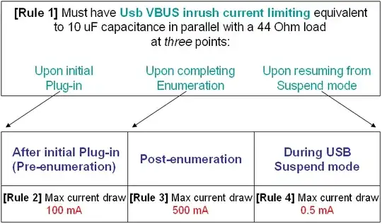

Four USB spec rules (three regarding Current draw maximums, and one regarding Inrush current limiting) pertinent to my particular situation are as follows: (Note: I'm showing different time-stages in this diagram:)
Rules

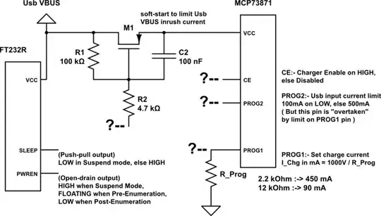

The functions of these useful pins for both above ICs are summarized in my (rough) attempted layout below. It's not yet complete, as indicated by the Question-marks at certain connections:
My layout
My layout

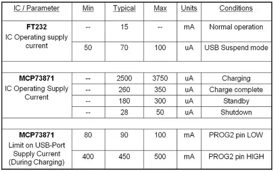

Finally, here are the situational current-draw specs for the two ICs. Of course, these current draws also have to be counted into the 0.5 / 100 / 500 mA current-draw limits on the USB supply: Current draw

As you could see in my layout earlier, I've set up an unconnected circuit (RC combination on MOSFET) for the soft start problem; and I've got the limit-setting resistor on the PROG1 pin, which could perhaps be used as part of a divider for partially solving the 500mA vs 100mA vs 0.5mA problem (based partly on FTDI's strategy in this app note). But that's as far as I was able to reach.

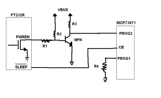

You don't need to current limit anything. Your MOSFET solution would only be useful to current limit inrush due to a capacitive load but your VDD pin is not capacitive nor would that circuit limit once it's already on. All you need to do is figure out how to use #PWREN and #SLEEP to switch in different resistor values. The MCP73871 does the rest.
  1. Just hook #SLEEP to #CE to take care of "standby".
  2. Add an inverter between #PWREN and #PROG2 but make sure floating input defaults the inverter output to LOW.
  3. Place a 2.2k pulldown on #PROG1
Note: make sure you have R1 because #PWREN will drive high and you need to limit the current into the NPN.

Perhaps a reset controller would be useful here; connect its output to the RC network for startup. Then take SLEEP, invert it, and it with the reset signal, and feed it to CE. For PWREN, create a voltage divider at about 1.5V or so. Put it through an inverting comparator against 1V, and feed that to PROG2.

  • Can you draw a schematic, it would be much easier to follow then a text explanation and you could then use text to explain the schematic. – Kortuk Sep 21 '12 at 10:12
