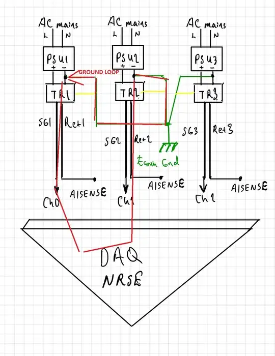

Several single ended output and PSU powered transducers are tens of meters apart from each other outputting 0 to 10V DC like voltages.
Some are temperature transducers some are force transducers ect. Their outputs all go to a single DAQ board which essentially multiplexes these channels and logs the data.
The DAQ board is also single ended and non referenced earth grounded and named as NRSE in the below illustration. The transducer signals are conveyed through BNC coaxial cables. Tr represents transducers below:
I’m planning to star-ground all power supply negative terminals and sensor shields at a single point and earth ground them. So none of the sources will be floating wrt earth. Since the DAQ is NRSE its analog ground will be floating with respect to earth.
I only found this document related topic http://www.ni.com/white-paper/3344/en/.
And mine is the one below encircled in red:
In my case, as I have explained with my first illustration many inputs actually nine inputs from transducers apart from each other will be coupled to the DAQ in NRSE configuration.
Do I really need to star-ground the DC negative terminals and transducer shields at a single point? SG is the signal Ret is the return wires going to the AISENSE. (For a particular case I got a better result earthing the DC terminal instead of return wire; it was CM interference due to SMPS transformer), thats why I earth ground the transducer’s from their power supply negative terminal in my illustration.
Edit:
Basically what Im asking is the star connected node(red question mark) need to be earth grounded as well?:
Edit: enter image description here
AI SENSE is like diff ended with common returns.
AI GND and AI SENSE should not be connected thats what I heard from manufacturer for AI SENSE used scheme. Figure 1 SE scheme must not be used it causes parasitically coupled ground loops.
Now the transducers are powered by power supplies and power supply ground and transducer ground is not isolated.
In Figure 2 if I use AI SENSE and if I also route PSU ground to AIGND or to the nearest earth I get very good results. So it seems to me if I use AI SENSE scheme and a third wire from the red point(the PSU ground) to the nearest earth(yellow) or to AIGND(green) things are fine.
But since I have many of these I was asking should I use the green or yellow route in Figure 2.? Also there are 10 inputs in that case where should these yellow or green wires be star grounded?
But I can assure you SE scheme and tying AI GND to AI SENSE cannot be done. So please the answer be none of that two. AI GND is always earthed through PC motherboard. AI SENSE should not be wired to AI GND. Pls provide a simple drawing in the answer makes things easier to follow.

  • I think this depends on the existence of electric fields that couple onto the wiring from the sensors. Those electric fields will induce charges, with these charges taking all possible paths back home. Will you have cleaner measurements, if *YOU* provide the lowest path (the earth ground)? By the way, I upvoted your question, because I want to see how experts (I ain't an expert) will handle this question. – analogsystemsrf Oct 23 '18 at 05:23
  • Please update your diagrams with what you plan on doing with the DAQ ground, and whether the power supplies will be located close to the DAQ or with the sensors. Pleas also show what the DAQ is and analog and whether there is any isolation – Voltage Spike Oct 25 '18 at 18:00
  • To answer this question it's important to know how TR1..3 work. Is their output isolated from the input? Can you add schematics of their output stage? If it's not you have your first ground loop in your first image. – Andy Oct 27 '18 at 08:19
  • Made an edit hopefully more clear. – floppy380 Oct 27 '18 at 16:53
  • Just a comment; not an answer: with cables this long you may have substantial noise problems. A common solution is to use transducers with current output (4-20mA) instead of voltage output (0-10V). I suppose it's too late for this project, but something to think about... – bitsmack Oct 28 '18 at 08:17

Basically what I'm asking is the star connected node(red question mark) need to be earth grounded as well?
No, a star ground is only going to add more ground loops and more noise, since you are likely in a good configuration already as per this comment:
The idea is to do what works for the noise levels the system needs to attain. If you build the system, and the noise is acceptable for the measurements that need to be made, then your done! Figure 1 would be preferable to figure 2, remember the figures in the NI document are best practices. The environment or setup that you have might not have as much noise, really you would need to have a diagram of the power supply, how its connected to each transducer and a knowledge of the grounding of the DAQ.

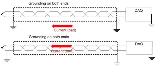

The first concept to understand is that of a ground loop. The ground loop starts because there are two points of grounding with two cables. This forms a large loop, if magnetic fields run through the loop (from motors and power lines) it creates a current that runs around the edge of the loop. This creates a problem even with shielded cables via inductive coupling (shielded cables only protect against capacitvely coupled electric fields and block them, but not magnetic), in which a current on the outside of the cable also causes a current on the inside. In most cases it is best to avoid ground loops.
With a DAQ this creates problems because you might not have total control of the grounding of the sensor wires or the shield.
If ground loop currents are the biggest source of noise (which depends on the electric\magnetic environment that the system is in) then the best thing to do is break the loop. This can be done by removing one ground (best practice) or by disconnecting the shield (preferably next to the sensor.
Another thing that can be done is to add isolation to the analog signals to break a ground loop, this can be more expensive, but is better.

It is also good to use twisted pair wire to eliminate loops and keep noise down (this is why most differential signals like RS485 or ethernet have twisted pair.

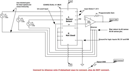

There is no reason to have your analog inputs Earth grounded. It does nothing except offer a path for noise to get into your analog signal.
I have assembled some complex ATE equipment with all types of issues. First rule is each source stands on its own until it reaches a differential op-amp or ADC MUX.
Get rid of all your red and green lines. The black signal wires are ok as is. Return all blue wires to the AIsense pin or use a dual-port MUX. Connect it to common signal ground if the PGIA datasheet shows it to be necessary.
You want to avoid having AIsense cross-connected before reaching the PGIA. This avoids signals leaking into other channels.
Do NOT connect high energy devices directly to these inputs or AIsense. It can damage the PGIA and MUX and ADC. Use an analog isolation module (AD210KN) for such devices.
Avoid earth grounds, it's just a long wire that acts as a source for RF noise pickup. Keep what wires you need short and twisted if you cannot shield them using STP (Shielded Twisted Pairs). If you do use shielded wires the ground of the shield should only connect to signal ground at the PGIA or close to it. The shield wire must be quiet and that is a quiet spot.
In the below schematic a dual 4:1 mux allows the signal to select only 1 sensor at a time. Channel 'B' is not used. Since the sensors always have an AI sense connection they do not 'float'. The CD4052 MUX is very low cost and has high channel to channel isolation. Read the data sheet before using it.
There is NO connection to Earth ground and signal sources never share a common connection until they reach the AI sense pin. That is your 'star' point. If not selected the sources have no load, but that should not be an issue for a source. If sensor wires have a long run then add clamp diodes to Vss and Vee (1N4148) which will protect the CD4052 from voltage spikes over 10 volts, but sensor wires should not run anywhere near AC power feeds.
Note that figure 4 in your NI documents is almost identical to this set up except you have just a 4 channel SE input instead of 8.
Link to CD4052 datasheet

  • @user1234. I changed the schematic so you now have SE inputs with a 'star' topology for the AI sense return, at the AI sense pin of the PGIA. I removed the connection from AI sense to signal ground to avoid confusion. I modified my answer as well. –  Nov 02 '18 at 04:52
