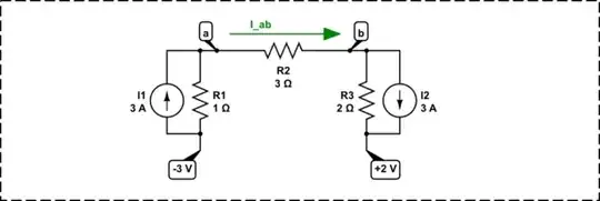

I'm experiencing problem while solving the circuit problem and finding Iab: It is because there is a voltage source on the branch which is connected to the left node. Please, help me to find the current Iab

  • I know that English is often a 2nd or 3rd language and that it can be hard to do, but you really do need to explain what you already know how to do and what you've tried to do and do it in English. You can provide some work when you ask a question. It's your question, after all. That said, if you can find the voltage at node 'a' and at node 'b', then you can work out the current. Do you know how to find node voltages? What techniques are you familiar with, already? – jonk Oct 19 '18 at 18:42
  • A couple of things you can do, though, is remove a few parts by replacing them with a wire. The \$2\:\text{V}\$ voltage supply on the upper-left side serves no analytical function and can be replaced with a wire. Similarly, the \$2\:\Omega\$ resistor that is in series with the \$3\:\text{A}\$ current source on the vertical circuit branch to the right of middle can also be removed and replaced by a wire. It serves no analytical purpose, also. Just as starters. – jonk Oct 19 '18 at 19:07
  • Have you tried Mesh-Current Analysis? This is a very good way to approach this problem. If you do this, there will be a supermesh. –  Oct 19 '18 at 19:18
  • You need node equations at both 'a' and 'b'. These are quite straightforward. If you sum currents away from each node and equate to zero, calculation errors will be minimised. No need to redraw the circuit,. – Chu Oct 20 '18 at 01:02

Let's start by selecting a convenient ground reference (the bottom wire of your schematic) and re-draw the schematic:
I've color-coded each box to make them stand out more distinctly, but I've also included a name for each box below to help those who may not see color differences as well as I do.
First thing to note is that I've simplified the diagram, somewhat, by removing all the busing of wire around for your bottom wire in your schematic. So long as you keep in mind that these ground connections are still connected to each other, the advantage here is that there's some distracting lines removed now and it's a little bit easier to "think about."
Looking at BOX 1, the reason you can eliminate (short across with a wire) \$V_1\$ is that the current won't change no matter what the voltage value happens to be. Whatever the value of \$V_a\$ may happen to be, the only thing \$V_1\$ does is change the voltage drop across \$I_1\$ and the current source \$I_1\$ doesn't care about that. It still provides the same current, regardless of its voltage drop. So \$V_1\$ is completely irrelevant for the purposes of analyzing \$V_a\$ or \$V_b\$. You can lose \$V_1\$ and what happens is that the voltage drop across \$I_1\$ changes by just that much. So what? Just remove it.
Note that you wrote that you are:
experiencing problem while solving the circuit problem ... because there is a voltage source on the branch which is connected to the left node
So, I'm just telling you here and now that it should NOT confuse you. Just get rid of it. However, in the interest of showing you how it doesn't matter I'll keep it in place for now. You probably need more convincing, not just hand-waving about it. So let's keep it in BOX 1 for now.
(The same arguments would go for BOX 3. But again, let's leave things as they are.)
BOX 2 and BOX 4 are each voltage sources in series with a resistor. These could technically be replaced with a Norton equivalent, with current sources and a parallel resistor. At times, that approach may help simplify the analysis. This might actually be one of those cases, too -- but again I think I'll just leave things as they are.
Okay. So that's it for my hand-waving. Outside of that, all I've really done here is re-draw the schematic. So now let's analyze it.
Here are the nodal equations to solve (out-flowing currents on the left side, in-flowing currents on the right side):
$$\begin{align*} \frac{V_a}{R_1}+\frac{V_a}{R_2}&=\frac{V_2}{R_1}+\frac{V_b}{R_2}+I_1\\\\ \frac{V_b}{R_2}+\frac{V_b}{R_3}+I_2&=\frac{V_a}{R_2}+\frac{V_3}{R_3} \end{align*}$$
Note that in the above pair of equations (the two unknowns are \$V_a\$ and \$V_b\$), neither \$V_1\$ nor \$R_4\$ show up. As I said, they are irrelevant for the reasons I talked about. You can see that \$I_1\$ shows up in the first equation as an in-flowing current. Take careful note that this in-flowing current is completely unaffected by \$V_1\$. You can also see that \$I_2\$ shows up in the second equation as an out-flowing current. And again take careful note that this out-flowing current is completely unaffected by \$R_4\$.
The above equations can be re-arranged into a more standard form for solution:
$$\begin{align*} \frac{V_a}{1\:\Omega}+\frac{V_a}{3\:\Omega}&=\frac{-3\:\text{V}}{1\:\Omega}+\frac{V_b}{3\:\Omega}+3\:\text{A}\\\\ V_a\cdot\left(1+\frac13\right)+V_b\cdot\left(-\frac13\right)&=0\:\text{A}\\\\ &\text{and,}\\\\ \frac{V_b}{3\:\Omega}+\frac{V_b}{2\:\Omega}+3\:\text{A}&=\frac{V_a}{3\:\Omega}+\frac{+2\:\text{V}}{2\:\Omega}\\\\ V_a\cdot\left(-\frac13\right)+V_b\cdot\left(\frac13+\frac12\right)&=-2\:\text{A} \end{align*}$$
At this point, you should find it very easy to work out that \$V_a=-\frac23\:\text{V}\$ and \$V_b=-\frac83\:\text{V}\$. Hence, the voltage across \$R_2\$ has the magnitude of \$V_a-V_b=+2\:\text{V}\$ and from this it should be trivial to calculate the indicated current you want, \$I_{a\:b}\$.
In case it helps, here's a highly simplified equivalent schematic:
simulate this circuit
Note that in the above case, I didn't even bother with showing anything at all on one side of the current sources shown there. There's no point. It doesn't matter. It's enough to know the value of the current sources, and direction.
There's more that can be done, now. Let's first take my above comment, where I don't even "bother with showing anything at all on one side of the current sources", and now make a small change expanding on that idea:
As I said, it doesn't matter. So it's just fine to hook up the other end of any current source to any voltage source I want. In this case, I just arranged it in a way that should make the next step obvious.
At this point, we can convert what now appears to be obvious Norton sources into Thevenin sources. You can treat the left side consisting of \$I_1\$ and \$R_1\$ as a Norton source and convert it to a Thevenin source, instead. You can similarly also treat the right side consisting of \$I_2\$ and \$R_3\$ as yet another Norton source and convert it to a Thevenin source, too. The result is this:
Now the current is trivial to compute:
$$I_{a\:b}=\frac{0\:\text{V}-\left(-4\:\text{V}\right)}{1\:\Omega+3\:\Omega+2\:\Omega}=\frac{4\:\text{V}}{6\:\Omega}=\frac{2}{3}\:\text{A}$$
So, as you can see there are a number of ways to get the same answer. And, in fact, one way doesn't even require the simultaneous solution of two equations with two unknowns. It just becomes a nearly trivial series circuit to solve with Ohm's Law.
