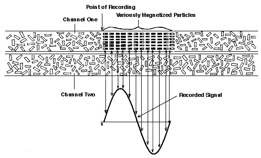

It is neither, the signal is recorded as a magnetized pattern without any form of modulation. This can give an impression of how that works:
I got that from here.
See, no modulation needed, the amount of magnetic flux is proportional to the actual audio signal.
Some HiFi Stereo Video recorders do use FM to record the audio though.
Bimpelrekkie
  • 80,139
  • 93
  • 183
    That page is not really an accurate description. It is not the particles that are realigned during recording, it is the magnetic domains within the particles (depending on the technology, each particle can have one or more domains, in rough sense they define the analog resolution of the material). They way that is presented on the slide is misleading IMO. The domains are groups of magnetic moments that share a common orientation. It is akin to a crystallization pattern when the material is brought below its Curie temperature. If they kept the random orientation it would have been closer. – user201365 Oct 18 '18 at 15:01
    how long does it take for those moments to decay? :o – Daniel Oct 18 '18 at 19:16
    @Daniel If the material is stored at room temperature or lower, the "magnetic decay times" are tens or hundreds of years. In practice, the plastic tape in old recordings deteriorates far quicker, and that often leads to some of the magnetic material being physically stripped off the tape every time it is played. That obviously can produce a rapid decay in the sound reproduction quality. – alephzero Oct 19 '18 at 18:27
