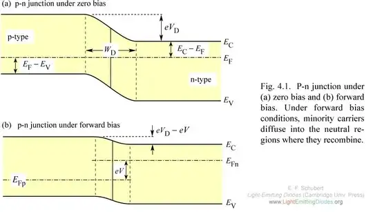

The minority carriers (holes in the n-type and electrons in the p-type) aren't pushed away from the depletion region because there is no electric field outside the depletion region (under equilibrium with no externally applied voltage).
To understand why, look at the electric field of an infinitely large sheet of charge. The electric field is constant, regardless of your distance from the sheet of charge. Electric field due to an infinite thin flat sheet of charge
Now take two infinite sheets of equal but opposite charge in parallel. The electric field between the sheets combine to form a uniform field from the positive to the negative sheet, but outside the sheets of charge the electric fields cancel out.
Electric fields from two parallel sheets of charge Combination of electric fields from two parallel sheets of charge
Images Source: Electric field in a parallel plate capacitor
If you think of the depletion region as two sheets of infinite charge, you can see why there is no electric field outside the depletion region. A hole in the n-type material that gets close to the edge of the depletion region would feel an electrostatic repulsion from the uncovered positive atoms and an equal-but-opposite attraction to the uncovered negative atoms, resulting in zero net force. This is also why the free electrons in the n-type material and free holes in the p-type material aren't attracted to the edge of the depletion region.
