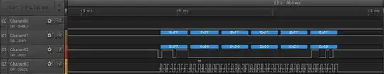

The logic data file after making changes as Anonymous suggested in the answer

The issue I am facing is I am getting the command and response for the 1st two commands correctly that is CMD0 and CMD8 and I am not facing any issue no matter how many times I try. When I send the third command i.e :
1) CMD58 as per the SD Org document , I dont get any response back. 2) CMD55 as per the person's answer on this SE, I seem to get correct response but the reponse I read get's an 0xF before the reponse so I believe that SD Card starts reponding from halfway of the clock generated. So I hooked up logic analyzer to it and here are the results.
Command 55 : Command 55
No Response on the first clock : No Response
Response : Response

  • I adapted the code as per the points you made, Solved the issue for that command. But now I am getting 3F for CMD0. I am attaching the logicdata file in the question. – MaNyYaCk Oct 12 '18 at 09:15
  • I noticed that for all the commands MISO stays high when receiving the command and then goes low. But for the first command it stays low only. Could the issue be there? – MaNyYaCk Oct 12 '18 at 09:33
  • In my implementation after power on or card insertion I set CS low and clock it low speed with MOSI high for about 600 ms (if I am reading my code properly :). It is a lot of time, but there were no reports on any card initialization issues. – Anonymous Oct 12 '18 at 10:01
  • It is no longer an initialization issue. The initialization process works and is fine. But the response I get is not what the SD card seems to be sending. It understands that It has given the correct response, But that is not what my code as well as Logic Analyzer see for just the CMD0. It would be great help for me if you could check out the logic data file I attached in the question – MaNyYaCk Oct 12 '18 at 10:21
