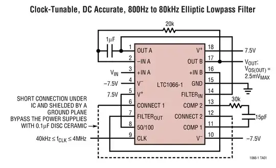

I'd implement this as shown here

  • @ Tony I've seen (in simulations) the two-caps-one-resistor network be able to provide the transient charges needed, but also be able to quickly dampen. – analogsystemsrf Oct 18 '18 at 03:11
  • Yes you can see any simulation with ESR, ESL added to tracks.caps , source and load with this. Q will relate to X(f)/Rs. All caps must have non-zero ESR. – Tony Stewart EE75 Oct 18 '18 at 16:19
