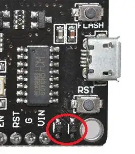

Looking at photos of the "problem" board from your supplier's link, I noticed this part of the PCB is different than the "working board". See the 2 diodes in the red ring:
cropped view of top of "problem" NodeMCU ESP8266 PCB
(Image source - Vendor "ModuleFans" on AliExpress)
I suspect these 2 diodes are forming a Diode-OR for the two possible 5V inputs - the USB port and the Vin pin. This will prevent backpowering whichever of those two power supply sources is not used.
That means you cannot use Vin pin as a power output on that version of the board.

You would need to find and compare the schematics of the two boards (or reverse-engineer that part of the two boards yourself) to be completely sure. However my hypothesis, and seeing the different components on those two boards, support and explain the test results you have seen.

  • WOW ! I was following pin my my board, and compared it to the one on that link- and I was absolutely sure they were the same. thank you very much !! too bad I can;t get that Vin I need though ( any idea will be appreciated ). Guy – guyd Oct 09 '18 at 17:54
  • @Guy.D *too bad I can;t get that Vin I need though ( any idea will be appreciated )* - If you are sure you will only use the `Vin`pin as an output to power peripherals, and will never connect a power *source* there, and *if* you confirm that one of those diodes has its anode connected to the `Vin` pin, then you could consider shorting *that* diode (either leaving the physical diode in place or not, depending on soldering equipment etc.). After that, you would effectively "defeat" the backpowering protection to the `Vin` pin. (I take no responsibility for this suggestion, without a schematic). – SamGibson Oct 09 '18 at 18:03
