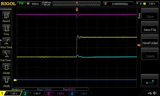

Simulating the above circuit shows a decent square wave both at input and output. However the actual signal I'm seeing on an oscilloscope is below. Here the slew rate seems to be around 1V/40us, not the 3V/us the datasheet describes.

Scope detail on 6.5 V input voltage (probing the AD820 power pins). Note the 500ns scale - The 2 V transition should be fully visible here at 3 V/us.
