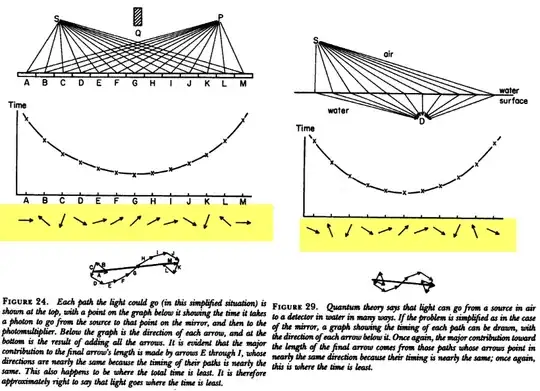

The material absorption is constant. The phase of the photons oscillation is what changes absorption, reflection, and transmittance.
The image below is from Richard Feynman's lecture on quantum electo-dynamics and the theory of photons. The phase of the photon's oscillation is represented by the direction of the arrow's angle (highlighted).
