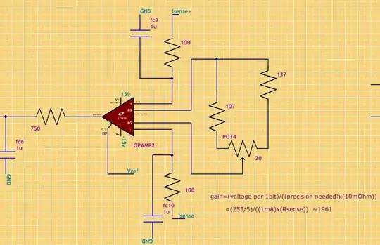

Schematic, Isense+/- connect to the shunt resistor. enter image description here

    You have to learn about kelvin connection. Neither a PCB can solve the wrong way of your measuring method. – Marko Buršič Sep 26 '18 at 12:52
  • Can you post a picture of your setup, and a schematic? – Vladimir Cravero Sep 26 '18 at 12:55
    Use a 4 point shunt to have a correct measurement – Damien Sep 26 '18 at 12:57
  • 4 point shunt? I need to check that out. gimme a minute I'll post some pictures. – Tony Sep 26 '18 at 12:58
    The "kelvin connection" mentioned by Marko and the "4 point shunt" mentioned by Damien are referring to the same thing by the way. A resistor with four connections, two for current and two for voltage, so the contact resistances don't affect the measurement. – Jack B Sep 26 '18 at 13:00
