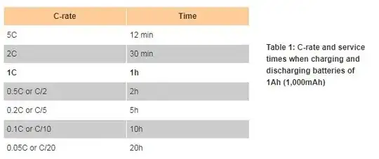

(Image from https://batteryuniversity.com/learn/article/what_is_the_c_rate)
With this table i guess it should clarify your question.
In short C20≠20C
Zy Gan
  • 336
  • There is no reference to C20 in that table. – Transistor Sep 26 '18 at 06:18
  • The C/20 refers to C20 based on the discharge time calculation, and this matches with the explanation in the link provided by John in the comment section of the question. – Zy Gan Sep 26 '18 at 06:27
