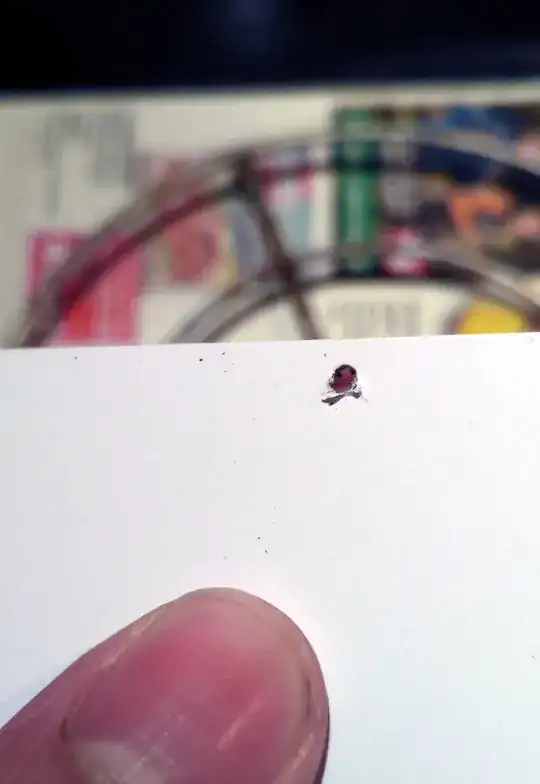

Thanks to @Passerby for the answer. I suggest using the heated needle method if you have a needle lying around somewhere and don't have any special tools. I can confirm that it works perfectly (see image below)
the result

    A hardware punch and hammer. A drill. A needle and lighter to melt a hole. A nail and hammer. A nail and a lighter. The problem is simply you need to be sure your not cutting the coil. If you can easily replace the rfid card, then messing up isn't an issue, but if you can't... – Passerby Sep 25 '18 at 18:34
  • using a needle sounds the safest (and the most accessable). Do I like heat the area with the lighter and then hammer a needle through the card? Will the card crack? will the card stop working if I heat it using a lighter? – Programer Beginner Sep 25 '18 at 18:36
    Heat the needle, In pliers. Push the hot needle through the plastic. Don't breathe in the fumes. – Passerby Sep 25 '18 at 19:08
  • @program I am not responsible if you hurt yourself or broke the card tho. Use common sense. – Passerby Sep 25 '18 at 19:10
    I can confirm that _pushing a hot needle through the plastic_ works like a charm! Thanks. Also really appreciate the **warning** about the toxic fumes from the plastic. – Programer Beginner Sep 25 '18 at 22:15
