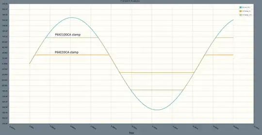

If all you are looking for is to detect that AC is present within reasonable limits (what are your limits??), I'd use a peak detector based on your TVS.
Something like this:
I've shown two schematics here, one with a 33V clamp and one with a 96V clamp, just to show options. Obviously you only need to select one of them. The circuit will run under the simulator to see the differences in clamp voltage.
The signal you get from the opto-isolator will occur at some unknown time between initial conduction of the TVS (with its variable threshold) and the CTR of the opto. However the signal will be symmetrical around the AC input sine wave peak at 90Deg which you wanted to achieve.
There will be some minor fluctuation due to the capacitance of the TVS of course, but this should not concern you for your particular application.
I'd suggest that the P6KE100CA would be a better choice of TVS, but either would work.
The issue of surge suppression I see as separate to your issue of sensing presence, and you should of course have surge suppression on the AC input. This would typically be a VDR surge suppressor close to your AC input.

    Why remove the capacitors (your resistors now need to dissipate 0.6 and 1W)? And what is the purpose of the two branches - what kind of circuit would the two clamp voltages be fed to? – Reinderien Sep 25 '18 at 18:15
  • The two branches simply allow you to simulate both ….you would only need one of them of course. Getting rid of the capacitors gets rid of the uncertainty of pulse position (phase compared to AC input). You have to also include the power dissipated by the TVS of course, but I don't consider it excessive. In the end it's up to you, but you tried to achieve a 90deg sensing phase shift with capacitors and can see it is ineffective. At no time did you say absolute low power was the objective. There are ways to achieve very low power sensing, but it's more complicated. – Jack Creasey Sep 25 '18 at 19:00
